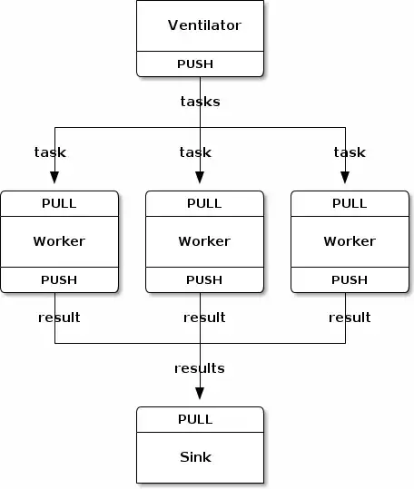

Have you considered using 0MQ (Zero Message Queue)?
They demonstrate the use of a parallel processing model using a ventilator/sink.
The ventilator pushes tasks to a collection of workers that handle tasks in parallel. When a worker finishes it pushes the result to the sink.
Here's the diagram:
Parallel processing using a ventilator/sink model
Source: 0MQ - The Guide
The library supports communications over most/all of the common interfaces (ex sockets, pipes, IPC, etc) and the examples have working code for all of the most common languages.
A server-client architecture doesn't really work here, as that would require a lot of unnecessary overhead to maintain the connection streams. A pub/sub (ie publisher/subscriber) model fits a lot better.
