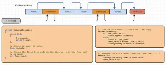

  1. Global entity storage Make a field in Server to store all Entity instances mapped by entity IDs.
In my case the entities became stored in a central array and referred to by index into the array. To allow constant-time removal of any entity without invalidating indices to other elements, the array is simply allowed to have holes in it which are reclaimed upon subsequent insertions using a free list strategy, like so:
You can avoid having to treat entities as unions of the entity data itself or the next free index if you don't mind using a little extra memory to just store a stack of integers on the side for removed indices to reclaim. That's usually not too bad.
