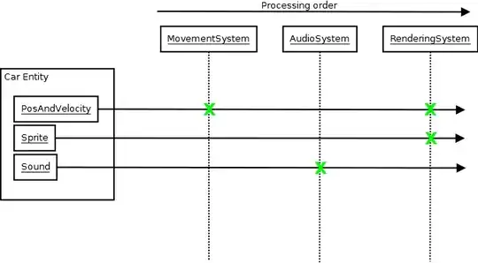

Meanwhile the most effective way I've ever witnessed after exhausting techniques to reduce compile times in large codebases are architectures which genuinely reduce the amount of information required for any one thing in the system to work, not just decoupling one header from another from a compiler perspective but requiring the users of these interfaces to do what they need to do while knowing (both from a human and compiler standpoint, true decoupling that goes beyond compiler dependencies) the bare minimum.
The ECS is just one example (and I'm not suggesting you use one), but encountering it showed me that you can have some really epic codebases that still build surprisingly quickly while happily utilizing templates and lots of other goodies because the ECS, by nature, creates a very decoupled architecture where systems only need to know about the ECS database and typically only a handful of component types (sometimes just one) to do their thing:
Design, Design, Design
And these sorts of decoupled architectural designs at a human, conceptual level is more effective in terms of minimizing compile-times than any of the techniques I explored above as your codebase grows and grows and grows, because that growth doesn't translate to your average compilation unit multiplying the amount information required at compilation and link times to work (any system which requires your average developer to include a boatload of stuff to do anything also requires them and not just the compiler to know about a great deal of information to do anything). It also has more benefits than reduced build times and untangling headers, since it also means your developers don't need to know much about the system beyond what is immediately required in order to do something with it.
If, for example, you can hire an expert physics developer to develop a physics engine for your AAA game which spans millions of LOC, and he can get started very quickly while knowing the absolute bare minimum information as far as things like types and interfaces available as well as your system concepts, then that's naturally going to translate to reduced amount of information for both him and the compiler to require to build his physics engine, and likewise translate to a great reduction in build times while generally implying that there's nothing resembling spaghetti anywhere in the system. And that's what I'm suggesting to prioritize above all these other techniques: how you design your systems. Exhausting other techniques will be icing on the top if you do it while, otherwise, it can be like icing without the cake in the worst-case scenario.
