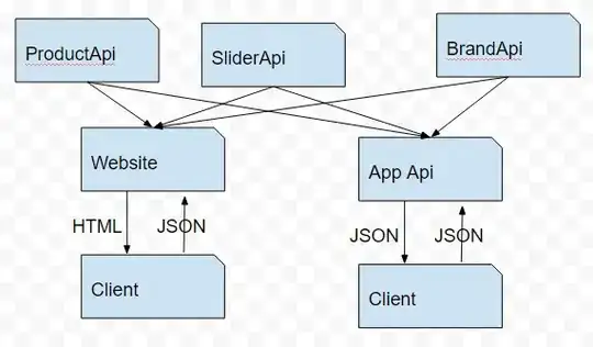

In Theory the multiple simultaneous calls are more flexible and just as fast.
However, in practice if you load a page, and then load each part of that page, displaying loading spinners all over it until you get the results back the result is slow and disjointed.
For this reason AJAX requests for data should be used sparingly and only when you have a section of the page which is slow to load or needs to be refreshed on a different cycle to the rest of the page. Say a master/detail display, where you want to select an option from the master and display the corresponding detail without reloading the master.
A common design is to keep the separate APIs for coding flexibility and micro-service concerns, but combine the data server side in the website. so that the client needs to make only a single call to its own website. The API calls with appropriate caching should be fast within the data center.
Also, consider having NO client API calls at all. simply generate the HTML server side. Although javascript single page app frameworks push you down the api route. It's usually not the optimal approach for high volume e-commerce sites.

  • Thanks, Actually This api is consumed in android and i phone apps, i want to know when app home page is loaded should i get all resources like: sliders, brands, products in single api call or make individual call to api for individual resource when users scrolls down ? – Shaiju T Feb 09 '17 at 09:39
  • The same logic applies, minimise the simultaneous calls where not required. An app gives you a bit more flexibility to download info in the background though. You might want to switch to a GetChangesSInce(date) approach – Ewan Feb 09 '17 at 09:49
  • So you conclude, its best to have single API to call for all home page resources response at once when App's home page loads and have different api's for sliders , brands etc seprately for micro-service when you have a section of the page to be updated ? – Shaiju T Feb 09 '17 at 10:29
  • not unless you have a good reason why those sections are not just loaded with the page/main data – Ewan Feb 09 '17 at 10:31
    I have last question how would apps like amazon , flipkart work ? Doesnt they load all home page resources at single call when user opens the app ? I am want to know what would be best approach on this. – Shaiju T Feb 09 '17 at 10:51
    yes, you can see amazon for example, loads a full page of products, then has separate calls for the user specific items, such as recent searches. this allows them to cache most of the page – Ewan Feb 09 '17 at 11:08
  • @Ewan What do you mean exactly by 'combine the data server side in the website' ? Let's say I need an id from an endpoint, in order to get company data using that id, from another endpoint. If I follow a microservices paradigm, I'll have two endpoints and therefore two consecutive calls in the frontend. While gathering the two calls will increase complexity. – Standaa - Remember Monica Jul 27 '17 at 19:51
    add a new backend endpoint which combines the two operations and call it once from the front end – Ewan Jul 27 '17 at 19:53
  • Just out of curiosity, now 4 years later, would you answer this question differently, either because of changes in technology or in your approach? – Eyeslandic Jan 30 '21 at 07:49
  • I think now, we would assume a Single Page App design which would allow you, like the app, to load all but one of the datasets up in advance and keep them in memory. However, even then for an Ecommerce site you want performance at all costs. If you can make a page with those dropdowns hardcoded into it and cache it, so no api calls are made, Then that site will sell more per server over xmas than a clever SPA – Ewan Jan 30 '21 at 09:40
