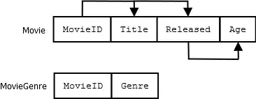

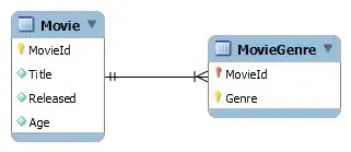

ER diagram with derived/multivalued attribute
Logical model:
Relational diagram with derived/multivalued attributes
Physical model:
Table diagram with derived/multivalued attributes

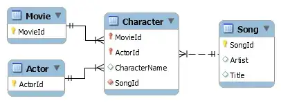

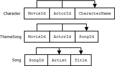

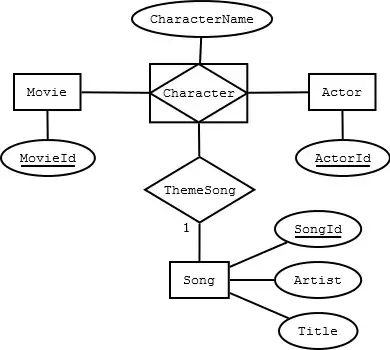

Associative entities are implemented exactly like relationships, since they are in fact just relationships that are the subject of further relationships.
Conceptual model:
ER diagram with associative entities
Logical model:
Relational model with associative entities
Physical model:
Physical model with associative entities
Note that in my physical model, I combined the Character and ThemeSong relationships due to having the same determinant (key).
