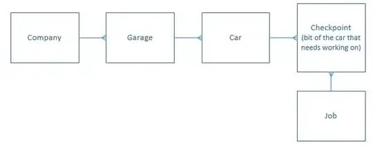

We have an Android app written as a Cordova AngularJS SPA which has now grown so that we need to add some work to it meaning we have to improve the synchronization part of the app. The app is mainly used offline. I can't give details of the business use but data structure and constraints can be illustrated with an over simplified car mechanic's business!
Imagine the data entities are similar to this : entity diagram
Claims are at Company, Garages and Car level, so in other words Jack may be able to see all garages and all cars in company A, Jill may be able to see all garages in Company A and only some cars in each garage, Jo may be able to see only one garage and only some of the cars in that garage. - you get the idea.

The required authorisation model is the part that seems to be the blocker to several solutions being viable, we need different users to have different sets of common data at a given time, this is imperative.
If you're going to sync against your master SQL database you will always have the same problem: how do you resolve conflicting changes?
CouchDB doesn't help you there. It explicitly does not handle conflicts and leaves it up the user to handle them (by picking sides). Other solutions also can't really help you, because to resolve a conflict you must understand the meaning of the data that is in a conflicting state. In other words, there is no generic "perfect" solution to this problem.
My advice would be to develop some solution yourself using that upload changes to a queue strategy you described. Performance likely won't be your biggest issue, but conflict resolution will be. Choose one of several strategies for handling that queue:
