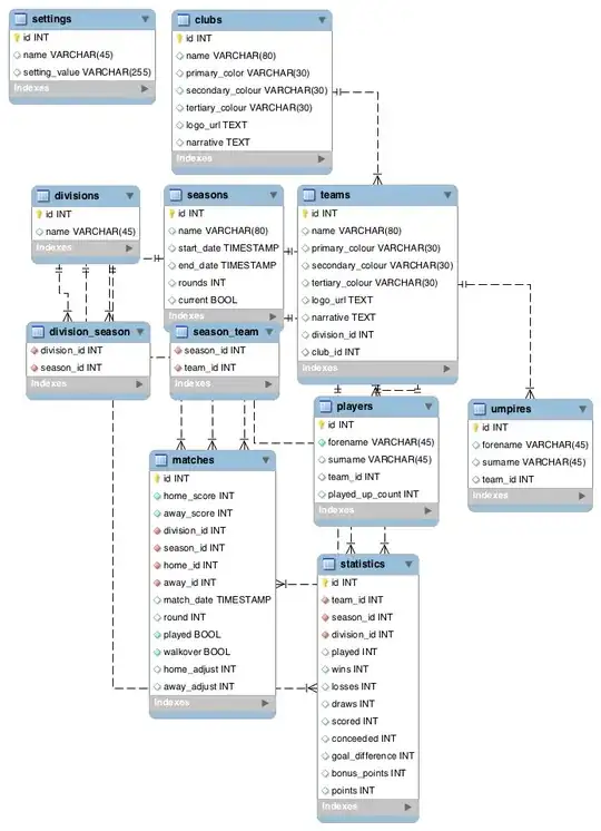

This application did not need many more nested resources such as this, it was relatively straightforward. However, I am now looking to create an API for existing application which has many more complex relationships. It is a league management app, EER diagram below:
Where I'm concerned is that I am going to need to query resources by a lot of different data - for example:
  1. teams by a specific division, season and round
  2. statistics by both team id and season id, and possibly round id also
  3. matches by season, round and division
and combinations of the above.
It therefore seems to me to make more sense to have a controller and route for each final resource, but to use query parameters rather than path variables.
For example:
https://myapi.com/matches?team_id={teamId}&season_id={seasonId}&roundId={roundId}
rather than:
https://myapi.com/seasons/{seasonId}/teams/{teamId}/matches
and the various extra controllers this would create.
However I feel this may be going against the grain in terms of what most people seem to suggest - see here for example. The second URL also seems neater to me.
