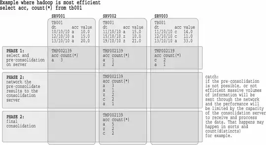

MapReduce allows you to create a program that will run on a distributed data center.
The program is divided in two phases. The first is sent to the servers where the data is and make a pre-calculation. The results of this phase is sent to the second part of the program to be consolidated.
This works best with data processing where the first part results is small. For example, a select account, count(*) can be run in each node to produce a partial result that is small and is sent to a server for consolidation which is the sum of sums. More or less like that:
Example of a sum query in hadoop-like systems
Although hadoop will work for things that are not easily partitionable, it will not be as efficient. Take the gray sort competition. Hadoop is fast to sort, but requires a lot more hardware than its competitors.
Hadoop will be effient for direct sums, select without joins and a lot of data analytics. Hadoop will not be as efficient for sorts, count(distinct), joins and etc. Matemathically speaking, it works best when the distributive property of mathematics work.
