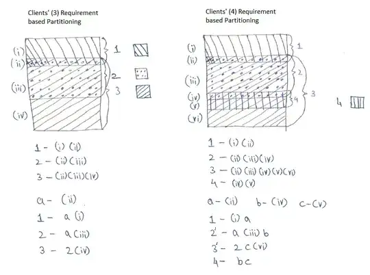

I have a module, say 'M', which has a few clients, say 'C1', 'C2', 'C3'. I want to apportion the module M's namespace, i.e. the declarations of the APIs and data it exposes, into header file(s) in such a way that -
  1. for any client only the data and APIs that it requires is visible; rest of the module's namespace is hidden from the client i.e. adhere to Interface Segregation principle.
  2. a declaration is not repeated in multiple header files i.e. not violate DRY.
  3. module M doesn't have any dependencies on its clients.
  4. a client is unaffected by the changes made in parts of the module M that is not used by it.
  5. existent clients are unaffected by the addition (or deletion) of more clients.
Currently I deal with this by dividing the module's namespace depending on the requirements of its clients. For example, in the image below the different parts of the module's namespace required by its 3 clients is shown. Client requirements have overlap. The module's namespace is divided into 4 separate header files - 'a', '1', '2' and '3'.
Module namespace partitioning
However, this violates some of the aforementioned requirements i.e. R3 and R5. Requirement 3 is violated because this partitioning depends on the nature of clients; also on the addition of a new client this partitioning changes and violates requirement 5. As can be seen in the right-side of the above image, with the addition of a new client the module's namespace is now divided into 7 header files - 'a', 'b', 'c', '1', '2*', '3*' and '4'. The header files meant for 2 of the older clients changes, thereby triggering their rebuild.
Is there a way to achieve Interface Segregation in C in a non-contrived manner?
If yes, how would you deal with the above example?
An unreal hypothetical solution I imagine would be -
The module has 1 fat header file covering its whole namespace. This header file is divided into addressable sections and subsections like a Wikipedia page. Each client then has a specific header file tailored for it. The client-specific header files are just a list of hyperlinks to the sections/subsections of the fat header file. And the build system must recognize a client-specific header file as 'modified' if any of the sections it points to in the Module's header is modified.
