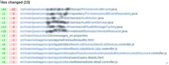

I am doing a code review for a commercial software system. I noticed that some user's story and even sub-tasks when are implemented they result in a large code commit and usually end up in changing tens of source code files (java classes, javascript files, HTML, etc)

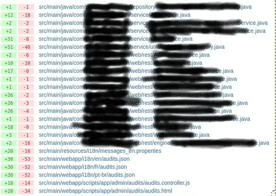

I expect that when someone implements a subtask or a single user story will only require changing few components. Sometimes the commit can have up to 60 files changed.
Attached a screenshot to illustrate the case enter image description here
another example
Note: I don't think my question is a duplication of I changed one method signature and now have over 25,000 errors. What now? In my case, I am trying to understand if the software suffers from high coupling or not by looking at the cost of code review. Why changing the behavior of a user story requires many changes in the source code?

Is this an indicator of high coupling?
Maybe.
Sometimes this is an indicator of high coupling because when one thing changes, it cascades along, impacting a bunch of other things.
Sometimes it's an indicator of loose coupling because when you want to do one sizable thing you need to touch all of the different responsibilities necessary to provide a cohesive feature to end users.
Full stack features tend to make this worse, since you get to do the front end, and the back end, and the tests for each, and the contracts for each.
Java tends to make this worse with its idiomatic BlahBlahServiceProviderFactory style need for classes to do everything.
Your need for internationalization will tend to make this worse, since you'll need to separate out resources from the code.
And frankly, code reviews tend to make this worse, since people want to avoid the overhead of the review, and reviewers want cohesive features to review, not small slices with things still in progress.
So while broad check-ins can be a sign of coupling, they're more often a practical side effect of business features necessarily crossing module boundaries.

  • OK, the system has several other components. I think I can compare the cost of code review and code change among the other components written by other teams or developers to see if the cost is similar or not. I personally, develop in Java and other languages but I do not have this large check-in pattern in my code. Although I wrote small micro-services. What do you think? – Ubaidah Dec 27 '16 at 21:24
  • This is why loose coupling is often a red herring. Tight coupling actually has some advantages. Solutions in Visual Studio are pretty much as tightly coupled as software gets, so loose coupling in those projects really only has meaning at software layer boundaries (where you can use interfaces or even strings to ease the problem). – Robert Harvey Dec 27 '16 at 21:48
