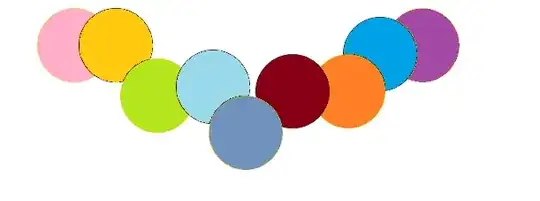

Say you were supposed to draw that. Seems simple. It's all circles. It's tempting to create a circle class that understands collisions. The problem is this sends us down a line of thinking that falls apart when we need 1000 circles.
We shouldn't be thinking about circles. We should be thinking about pixels.
What if I told you that the same code you use to draw these guys is what you can use to detect when they touch or even which ones the user is clicking on.

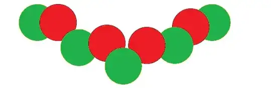

Here I've drawn each circle with a unique color (if your eyes are good enough to see the black outline, just ignore that). This means every pixel in this hidden image maps back to what drew it. A hashmap takes care of that nicely. You can actually do polymorphism this way.
This image you never have to show to the user. You create it with the same code that drew the first one. Just with different colors.
When the user clicks on a circle I know exactly which circle because only one circle is that color.
When I draw a circle on top of another I can quickly read every pixel I'm about to overwrite by dumping them in a set. When I'm done the set points to every circle it collided with and now I only have to call each one once to notify it of the collision.
