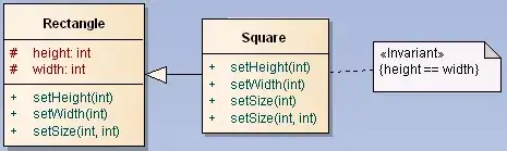

Rectangle must not inherit from Square. A square is a special form of a rectangle (where all sides have equal length). So the general form is Rectangle and Square is a specialization. So you can draw a generalization from Square to Rectangle, but not vice versa.
Regarding the Liskov-substitution: if you introduce constraints, you get around the pitfalls. Definitely it's tempting to "just inherit" but of course you still have your brain. And that revealed the problem behind the circle/ellipsis inheritance. So you need to be aware of what you are doing and care for the non-obvious. And: dogmatic programming is not necessarily good programming.
Let's look at a simple design: enter image description here
Since height/width are protected you need setter methods to alter them. And the constraint on Square will ensure that both height and width must be equal. Now, there can be different implementations for Square. Either a setHeight will as side effect alter the width (which does not seem to be a good idea). Or you raise an exception when trying to do so, which can be implemented in the overrides. As a convenience you can add a setSize with just a single int for height/width which is only available in Square. You can extend this design in similar way with various methods.
    But when we draw a generalization from Square to Rectangle there is a violation of the Liskov substitution principal, so there shouldn't be any relationship? Like I say, mathematically, this Rectangle inheriting behaviour from Square is counter intuitive, but most of the same functionality is there and it would not violate the Liskov substitution principal. – ampsthatgoto11 Dec 23 '16 at 17:25
  • See my added paragraph. –  Dec 23 '16 at 17:52
    *And: dogmatic programming is not necessarily good programming.* Well using inheritance which breaks tests, ie. breaks runtime, is even worse than dogmatic programming. I'd rather have a dogmatic programmer on my team than someone who just slaps an inheritance relationship between a rectangle and a square without even realizing it could violate something (because obviously a square is a special type of a rectangle), and boy it does. – Andy Dec 23 '16 at 17:58
  • @DavidPacker The above liked duplicate has a nice story for square/rectangle. But basically it's just a bad design that causes the issues. As I said: use your brain! –  Dec 23 '16 at 18:04
  • In the classic example where a `Square` has the property that its X and Y dimensions are equal and a `Rectangle` has the property that they may not be, you cannot generalize in either direction. – Kevin Krumwiede Dec 23 '16 at 20:25
  • @KevinKrumwiede It simply depends on the operations you provide. And how they respect the constraints put on being the one or the other. In the simple case where the class only offers width/height you can see that you will not run in issues as long as you use setters for width/height. Issues may start with certain operations. –  Dec 23 '16 at 22:40
  • @ThomasKilian If the classes have mutable properties of width and height, then it's plainly obvious that neither `Square` nor `Rectangle` can inherit from the other. Setting the width of a `Square` implies that the height will also be set, which must not be true of a `Rectangle`. Setting the width and height of a `Rectangle` to different values should result in the width and height being different, which must not be true of a `Square`. – Kevin Krumwiede Dec 23 '16 at 23:57
  • @KevinKrumwiede Didn't I say something about bad design? –  Dec 24 '16 at 09:24
  • @ThomasKilian It's not bad design. You seem to be hung up on the idea that classes called `Square` and `Rectangle` should correspond exactly to the mathematical concepts of the same name, which is not the case in this example. – Kevin Krumwiede Dec 24 '16 at 18:40
  • @KevinKrumwiede I model something so it has a certain behavior. When I model a generalization like above, it's because I want make use of a generalization, which is **convenient**. I'm not after some dogmatic Liskov and/or building an impossible complete axiomatic system. Good design is useful and correct design. –  Dec 24 '16 at 19:03
  • @ThomasKilian Liskov isn't dogmatic. It's an absolute requirement for good code. – Kevin Krumwiede Dec 24 '16 at 19:08
  • "I'm pretty sure that nobody can find a flaw in this" Oh well. SetSize is just another rectangle method, slapping it onto square and saying "See, square extends rectangle" is backward. You do not add a method and use that as proof for an inheritence relationship, it is the other way around. Name a trait of square that does not apply to any rectangle and you can start considering inheritence. And no, a constraint is not a trait. – Martin Maat Dec 27 '16 at 06:23
