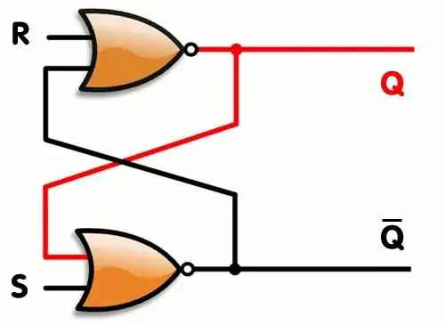

Consider this circuit:
It is a Flip Flop, aka a Bistable Multivibrator. It can be replaced with this code:
static bool toggle;
if (toggle == true)
    lblTop.BackColor = Color.Black;
    lblBottom.back Color = Color.Red;
else
    lblTop.BackColor = Color.Red;
    lblBottom.BackColor = Color.Black;
toggle = !toggle;
