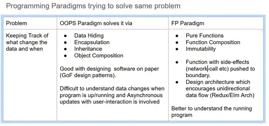

IMO, The above question should not arise. Functional programming concepts are not comparable to concepts in OOPS, they are just different ways of solving same problem. enter image description here
Anand
  • 181
    Did you make this table image just for the question? I think it would be better suited as text, so that it loads faster and can be observed with a screen reader – Phoenix Dec 21 '17 at 03:35
  • Doesn't OOP also encourage unidirectional data flow? Unless you consider OOP to be simply the concept of classes which can hold references to each other, but not proper design where bidirectional references typically indicate a design flaw. – Steven Jeuris Jun 04 '18 at 13:57
  • Most of the stuff that you mention under OOP and FP don't even have anything to do with the problem statement on the first column. function-composition for example only makes it harder to understand state structure and it's changes – Ski Jun 08 '18 at 16:53
  • It seems you prefer FP, but in my mind your answer just kinda confirms my feeling that it is a God object. Like OMG my state is so complex, because I'm treating the entire state of the entire program as one big thing. Yes, that's complex. In OOP, you have logical object models around that get updated which is not a big deal at all. If it happens asynchonously thats fine too. Views reflect the state of the object and it's very simple in practice. – n13 Sep 06 '18 at 09:20
