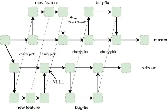

Let me offer alternative workflow, that may solve your versioning problem, or just help you think of more ways towards the solution.
A bit of philosophy first..
(I'm making few assumptions about your workflow, please correct me if I'm wrong)
  1. Tests are run retroactively:
    Branch out of maser to feature branch, then turn it into an artifact for testing by QA.
    the problem is: what if the tests fail, then master may be broken!
    side effects:
    • It make the developers not trust master
    • Since you branch out from master to release branches, what happens if previous release is broken? it stops your new feature integration until master is fixed again.
    • when bug is fixed in the release branch, merge back to master may create merge conflicts. (and we don't like conflicts)
  2. small code merges and fixes:
    Its hard to keep track of all code that is merged to master, like small fixes or changes that are not part of a certain feature.
    side effects:
    • developer is not sure if he should marge this small fix now or later.
    • should i version this new small fix as well?
    • At any point of time its not clear what is the state of master branch, and what code is floating in there
    • something broke the build, that is not part of the new feature. and its really hard to track where it came from
My idea for git work flow is as follows:
branch out of master for new feature development like you do already. but now instead of releasing from this newly created branch, have this feature cherry-picked and merged into the release branch.
Now you have better control over what is going into a certain release.
Now its really easy to isolate development versions and stable versions.
You can keep on building artifacts from those feature branches for QA.
If everything is ok, merge that feature back to master, and cherry-pick this feature/bug-fix/hot-fix into the release branch.
versioning
The feature branches version can use some name convention like 1.2.3-rc.12345
the the versions in the release branch will only use 1.2.3 (1.2.3 > 1.2.3-rc.12345 also one less thing to worry about)
This workflow fixes the problems mentioned above, and more.
It also propose sane versioning strategy, and most of this release cycle can be automated.
I hope it will help you in some way, i'll gladly discuss any edge cases you can come up with.
