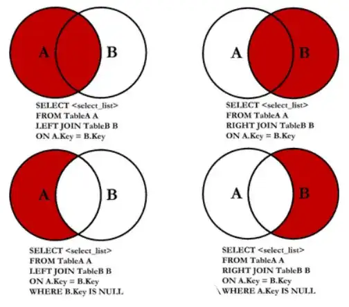

It's not the same to say: "gimme all persons and their corresponding orders" that "I want all orders with their corresponding persons", particularly if you are going to use is null to bring rows with no corresponding match. That's what I call the "dominant table", which is the table I want to fetch rows from regardless of there not being a correponding row in the other side of the join.
Look at this images and you will notice they are not the same:
Source of image is this excellent article.
But you are right in that both requirements can be fulfilled with either join just inverting the order of the tables in the join.

    I had begun to think along these lines, but I do not think it is correct. I started imagining writing SQL in Hebrew (which I have never actually done). OK: right justified, right-to-left, top-down. You will still mention table A first then table B. With a right join, you will then exclude (especially in the null case) most or all of the table mentioned first. I think that the human mind tends to associate **first** with **primary** and **most important**. This occurs regardless of writing direction. You could call them "FIRST JOIN" and "SECOND JOIN" and this bias would still occur. – Mike Nov 14 '16 at 19:59
  • I've include a link to the image you have shown below. – Jon Raynor Nov 14 '16 at 20:05
  • @Mike I'm not suggesting people write SQL in arabic or hebrew. Just that perhaps the orientation of your mother tongue could be a reason for you to prefer right-joins. But that is just a possibility. I find left joins more natural. – Tulains Córdova Nov 14 '16 at 20:07
  • Now I gave the due credit to the creator of the image. I've had it for years in my HD and I didn't remember where it came from, – Tulains Córdova Nov 14 '16 at 20:17
    I am fluent in Hebrew and I still find `LEFT JOIN` more natural. – Zev Spitz Nov 15 '16 at 05:32
