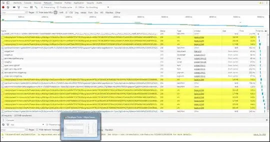

These days I have seen couple of sites (including Youtube) that stream videos through Ajax calls (XHR) in few MBs or even less than MB. For an example of what I said see the highlighted lines in the image below.
I want to know:
  • What this technique is called in programming terminology?
  • How it works?
