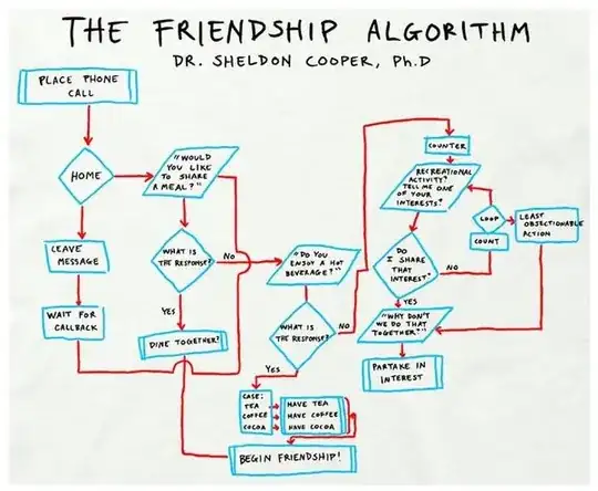

In flow-chart programming (which people of my generation learned, and was used for the Apollo moon program) you make a diagram with blocks for statement executions and diamonds for decisions, and you could connect them with lines that go all over the place. (So-called "spaghetti code".)
The problem with spaghetti code is that you, the programmer, could "know" it was right, but how could you prove it, to yourself or anybody else? In fact, it might actually have a potential misbehavior, and your knowledge that it is always correct could be wrong.

    behold [the friendship algoithm](https://www.youtube.com/watch?v=k0xgjUhEG3U) . Or just the [image here](http://bigbangtheory.wikia.com/wiki/File:The_Friendship_Algorithm.jpg) – bolov Oct 25 '16 at 09:15
  • The diagram you show is a reasonably well structured algorithm. It is emphatically not spaghetti code! (It's a loop with one break criteria and a couple of optional processing steps each guarded by conditions. There is no jumping into the loop, there is just a nice single loop exit, the whole diagram -- a subroutine? -- has a single entry and exit and thus is properly loosely coupled to callers.) Yes, one *could* draw all kinds of arrows in it, but they aren't there. It would, for example, translate nicely into a Nassi-Shneiderman diagram which was invented to prevent the arbitrary arrows. – Peter - Reinstate Monica Oct 25 '16 at 13:06
  • @PeterA.Schneider: You're right. I didn't claim it was spaghetti code, just a flow chart. Anyway, bolov's suggestion of the [*friendship algorithm*](http://bigbangtheory.wikia.com/wiki/File:The_Friendship_Algorithm.jpg) is a better choice, so I replaced the image. – Mike Dunlavey Oct 25 '16 at 13:44

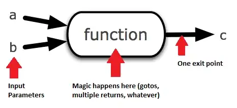

The famous Dijkstra article was written at a time when some programming languages were actually capable of creating subroutines having multiple entry and exit points. In other words, you could literally jump into the middle of a function, and jump out at any place within the function, without actually calling that function or returning from it in the conventional way. That's still true of assembly language. Nobody ever argues that such an approach is superior to the structured method of writing software that we now use.
In most modern programming languages, functions are very specifically defined with one entry and one exit point. The entry point is where you specify the parameters to the function and call it, and the exit point is where you return the resulting value and continue execution at the instruction following the original function call.
Within that function, you ought to be able to do whatever you wish, within reason. If putting a goto or two in the function makes it clearer or improves your speed, why not? The whole point of a function is to sequester a bit of clearly-defined functionality, so that you don't have to think about how it works internally anymore. Once it's written, you just use it.
And yes, you can have multiple return statements inside a function; there's still always one place in a proper function from which you return (the back side of the function, basically). That's not at all the same thing as jumping out of a function with a goto before it has a chance to properly return.
So it's not really about using goto's. It's about avoiding their abuse. Everyone agrees that you can make a terribly convoluted program using gotos, but you can do the same by abusing functions as well (it's just a lot easier to abuse gotos).
For what it's worth, ever since I graduated from line-number-style BASIC programs to structured programming using Pascal and curly-brace languages, I've never had to use a goto. The only time I've been tempted to use one is to do an early exit from a nested loop (in languages that don't support multi-level early exit from loops), but I can usually find another way that is cleaner.
