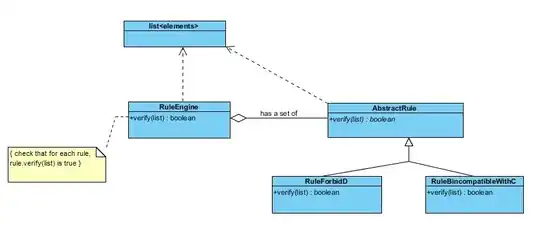

It's extremely simple to write a simple rule engine in an object oriented language, using the following design:
The knowledge base is a container (e.g. list) of rules, and the RuleEngine acts as the knowledge base checker, that applies all the rules to its input.
In this construct, you could derive a new class for each new kind of rules. In order to avoid unnecessary explosion of rule classes, you could also consider to use parametrized rules e.g. RuleForbidElement('D') instead of RuleForbidD.
You could save these rules to or load these rules from a file with usual serialization techniques.
By the way, you'll recognize here a simplified version of the interpreter pattern with only terminal nodes.
