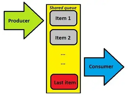

Basically the producer/consumer architectures use a queue that is fed by the producer(s) and read by the consumer(s):
The concurrency and racing conditions are all related to the management of the queue.
The simplest way to proceed would be to protect every queue access with a single mutex, held and released either by producer or the consumer. The problem in your scenario, is that the producer writes continuously new items until buffer is full, so there is a risk of letting the consumers starve until buffer is full, thus arriving de facto at a sequentialization of the processing.
The variants that you propose avoid starvation by ensuring a more balanced access to the shared queue (as for example the condition variable with the mutex).
But it is also possible to share a queue using two mutexes ! One such example consist of using a mutex for the head and a mutex for the tail (a so-called fine grained lock as implemented here)
