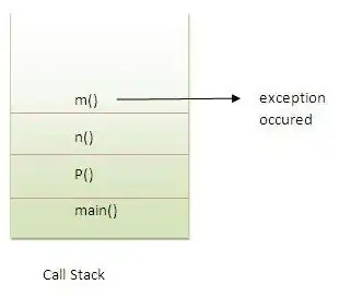

As it pertains to exceptions, strictly speaking, an exception propagates down the stack, from the most recently called function to the least recently called function. Google "exception propagation," and one of the first few results shows it like this:
However, when someone says "propagates up the stack," we understand what they mean. So, we don't fuss over it. Whether it's up or down in their heads isn't as relevant as whether they ultimately mean "most recent" to "least recent" (or "in opposite order of invocation").

    Then why do exceptions propagate "up the stack"? The top of the stack according to your definition is the currently executing function, so exceptions should propagate "down".. – max Oct 01 '16 at 17:05
  • Because people who say that are careless with their words, ignorant, or understand that the precise wording isn't as important as just understanding the underlying point. – svidgen Oct 01 '16 at 17:20
  • Hopefully my edits help to clarify. – svidgen Oct 01 '16 at 17:31
  • That makes sense, just wanted to make sure it's not some convention I didn't know about. – max Oct 01 '16 at 21:50
