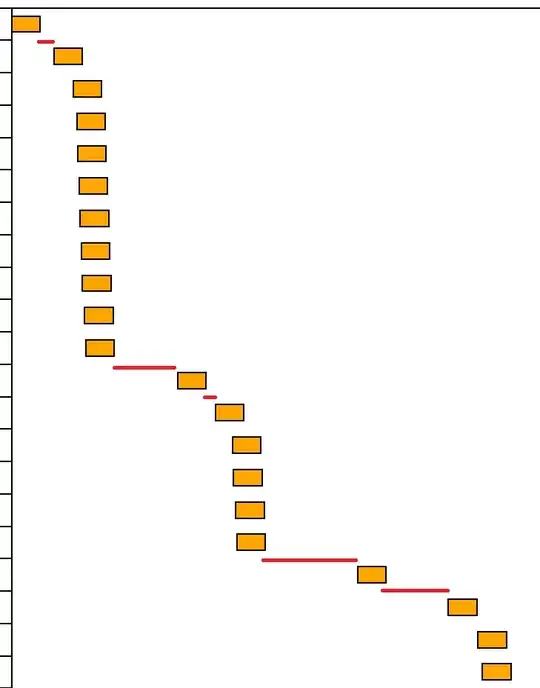

I have an array of elements, each with a start time and an end time.
These form a timeline, some of which overlap, and others that do not (and have a gap between groups of overlapping elements).
I written some code that removes the gaps between the non-overlapping elements (red lines as per the image below) however it is starting to get messy and not catching edge cases.
red gaps
Does an algorithm exist already that will remove the red gaps and shift everything up neatly?
My code stab is below:

  • each orange block is an array element (ordered by start time) which has a start and end time... some blocks overlap (in time) whereas others do not and there is a gap in time (the red line which indicates the duration), I would like to remove all the gaps (red lines) so that they butt up neatly together (but only the closest elements to the gap should align). – morleyc Sep 25 '16 at 19:42
You're trying to do too much in one loop. Subtracting the gaps is difficult because it's difficult to identify the gaps. Identifying the gaps is difficult because of all the weird ways the intervals overlap, so remove the overlapping interval problem first.
Make one pass to flatten the intervals, using an algorithm from this question. Then one pass to make a list of gaps, which should be very simple with the flattened list.
Now you're ready to loop through your original list of intervals. For each interval, see how many gaps occur before it, and subtract the cumulative time of each.

Posting this as the code, @Karl helped me realise splitting this up made it much easier! SOLID principles enables much easier code.
