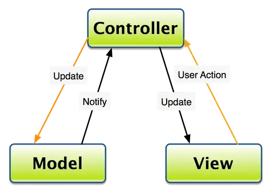

Controllers - logic that deals with moving the info stored in the models to the view and the other way around.
No.

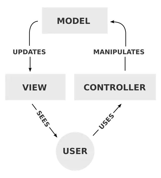

That's only true of certain implementations of MVC. That means you look like this:
Which you can do. But you can also do:
Here the controller doesn't even know the view exists. "What knows about what?" is the best architectural question I know.
There are many other forms of MVC. If studying it leaves you feeling like a lot of things aren't nailed down then you've been paying attention.
What this means is deciding to use MVC doesn't mean that much. You still have to decide what knows about what and how to talk to it.
