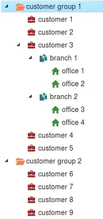

Our customer structure is like displayed here (simplified):
group-tree
One problem is that not all of the employees of some of our customers have e-mail addresses (I know, unbelieveable in 2016 but I can't change that so I have to work with it) so I can't use e-mail as a unique identifier for a login.
So my idea was to connect logins to groups in this tree and give each entry in this tree a unique identifier (e.g. customer 1 gets CUST1) which has to be entered in an extra input field on the login form which then allows us to use usernames multiple times (once per customer instead of once in total).
This means each login is connected to one fixed group. Customers must not see each other, so I build the tree for each login, so a member of "customer 3" sees only branch 1 and branch 2 and everything below.
However, now the real problem: today I got told that there cases where you want a user to see office 3 and office 2 but not office 1 and 4 and even different permissions for each group they have access to (e.g.: see appointments in office 3 and see appointments and files in office 2).
I originally had planned something like this: put users with permissions "read files" and "fill out forms" in "office 1" and that's it.
One idea I have is to split those groups and permissions completely. For example, all employees of customer 1 will be members of customer 1 without any permissions, no matter what branch or office they belong to and then in a second step they are assigned the permissions for each group/node inside that customer. But I'm pretty unsure on how to handle cases like "a new office gets added to branch 1".
Is there any good advice? I mean normally groups are flat but hierarchical groups with possible different permissions seems kinda complicated.
