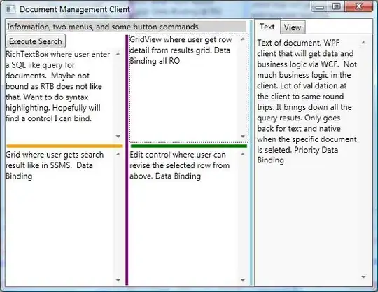

Have a plain WPF that started a proof of concept got demoed and bought and went down that path for a couple years.
Time to start fresh and would like to know proper pattern.
A WPF app that will talk to a WFP Service with a SQL data store.
The crazy light colors are sliders and clearly will not keep those colors.
What is a proper design pattern?
From what I have read I think MVVM
Not totally following the comment on MVM MVVM but it would be nice to have more than one View. The people that code will have different priorities than a high level person that is mainly view.
