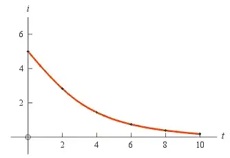

Another thing is defects. Over time the system should stabilize. Ideally new defects should trend toward zero or flatten out to a low number, which means new and current defects should decrease over time.
The plot should look something like this:
Defects Over Time Defects Over Times
If they stay constant or increase, then the software is not good. Your only 4 months in, so I would give it a few more months to a year. After 6 months to a year, if you had a constant stream of defects, then it's bad quality. Your team developed another ball of mud.

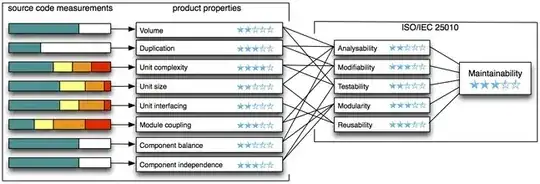

If you're looking for completely automated measurements, then I recommend these guys: Software Improvement Group
It's essentially an aggregate of various metrics that can be automatically extracted from the source code (like, unit test coverage, function size, class entanglement, duplication, LOC, etc.). Those values are then converted into 1-5 star rating.
They also have a decent book describing all their metrics in practice that's worth a read: 'Building Maintainable software'.
