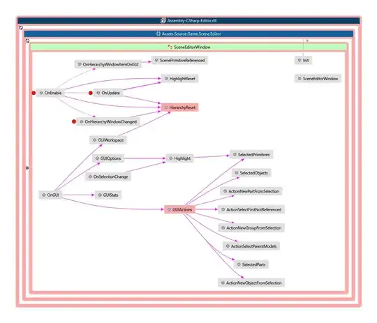

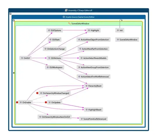

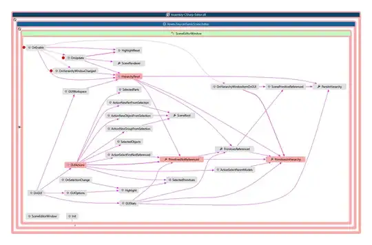

Now I am on the phase of fixing nasty bugs mainly due to events occurring from within Unity, such as when some values should be reset due to external changes and so on.
So I've decided to take a look at the class using Code Map in Visual Studio and it's getting increasingly harder to follow the structures thanks to the fixes aforementioned:
(members in red are Hubs found by Code Map) enter image description here

The 1st tip would be : know your tools
That helps a lot, filtering out non-essential stuff already gives a clearer view of the problem:
(properties have been filtered out) enter image description here
(cheap but handy refactoring: some methods converted to properties) enter image description here
2nd tip : attempt simple/affordable/easily reversible refactoring
(renamed some methods, introduced some 'hub' methods, defects already visible !)
At this point 10 minutes of small and easy changes but with significant gains !
Right, I have simply hidden some stuff in the diagram but it really helped out in finding my way in that mess. Devil-in-the-details code is already written, it wouldn't have changed anyway since that was (one of) the only way to do it.
