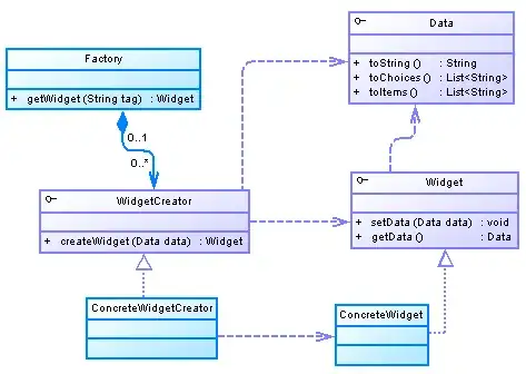

  • Been there, done that. Factory Method Pattern.
  • Factory has a static HashMap<String,WidgetCreator> so creating a widget is a matter of looking up it's creator in the Map and calling the create method. That's why no if or switchis needed.
  • You can put all creators and the Factory in a separate package for a cleaner workspace.
  • Also, as each type of Widget knows what method to call on Data, why not pass data instead?
  • I assumed choises and items are List<String>, you can choose otherwise.
  • UML first (this software paints interfaces purple instead of putting <<name>> in the title)
  • Code bellow.

void widgetReturnPressedEvent(Widget widget) {
    UserData data;
    widget.setData(data); // widget already knows how to handle the data

  • Isn't creating a `WidgetCreator` interface and implementing it for every widget a bit overkill? Why didn't you prefer just one Factory class? Thanks for the great answer btw. – isamert Aug 18 '16 at 13:50
  • @isamert Not really, creators are very short. They have just one method and your IDE even creates the class for you with the stubs for you to fill in (once you tell it it will implement the interface. You can put all those creators on a separate package and forget about them. I've done it in several projects and I got rid of all that pesky type-checking. If you were going to code with just NotePad I wouldn't recommend using this pattern. – Tulains Córdova Aug 18 '16 at 13:54
  • A less elegant alternative is the abstract factory pattern which has a method for every type of widget... getTextWidget(), getChoiceWidget() etc. But I think that would lead to conditionals again. – Tulains Córdova Aug 18 '16 at 14:01
  • Yet another alternative is a combination of abstract factory and method factory, that would be having the creators as inner classes of the factory. Also: I think the latest version of Java allows lambdas so you could just have creator methods in the HashMap as if methods were objects. But I' not yet familiarised with functional programming and or lambdas. – Tulains Córdova Aug 18 '16 at 14:04
  • Having the interface `WidgetCreator` helps the IDE create the boilerplate for you when you need a new `Creator`. Besides, that level of abstraction is needed for the pattern to work. Most design patterns rely on interfaces. – Tulains Córdova Aug 18 '16 at 14:11
  • It's easier to implement this level of abstraction in Java, but for example, in C++, it would make so much code with headers and stuff. But the lambda-way seems interesting, I assume I can use it in C++14. For Java, I'll stick this way. Thanks again for the further clarification. – isamert Aug 18 '16 at 14:21
