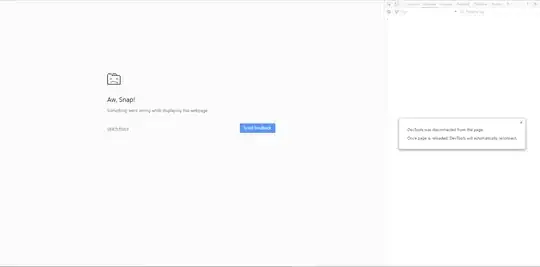

I have two Float32Arrays each one of which is 1.6*10^7 in length(floating point array). Using JS I retrieve them from server and add them element by element. My webpage stops responding and I get the following error message. Is there a way of handling huge arrays on client side without using JS or with JS?

    That's 128 freaking megabytes if my calculations are correct, and assuming you send them in perfectly packed binary rather than in JSON or something. It's debatable whether handling this much data on the client side is sensible, but *sending them from the server to the client* is insane. What do you need 32 million numbers for anyway? –  Aug 13 '16 at 22:10
  • why don't you retrieve it chunk by a chunk from the server, instead of retrieving it at once, get a chunk --> process it --> store the result on the client --> repeat – David Aug 19 '16 at 02:12
  • When you say add them element by element, do you mean using .push() on the array? It almost sounds like you mean adding to the DOM. – joshp Aug 21 '16 at 10:47
    What are you doing with these arrays once you retrieve them? I believe it is essential to know more details to guarantee a good answer. – kamoroso94 Aug 22 '16 at 02:38

The answer is that you can't process all that stuff toghether, because is too much.
You should rethink about what you are doing, some possible solution are:
  • split the data in chunks
  • reduce the size with filters
  • pre-elaborate on server side
  • ... be creative
