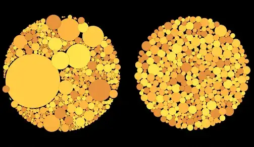

Does anyone know of any tool that would help find classes that are taking on too much responsibility?
E.g. By visualizing a file's size compared to the other files in the code base, it can be easy to spot massive classes that should probably be split up into much smaller ones.
I'm looking for something similar to the bubble chart Lyft used to compare their Objective-C and Swift code bases:

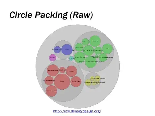

The right tool for this depends entirely on whether you need to show the problem in a slideshow or just need to see it for yourself.
If you need to present the problem to a large group, look up circle packing visualizations.

Always consider your audience when choosing a visualization.
