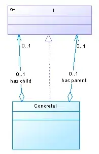

To solve that situation, don't use inheritance, use composition. But take in mind that both A and B shouldn't depend on each other. Both should depend on an abstraction (for example an interface) that both (or maybe just A) implement.
Strictly speaking this is not composition but aggregation but, in a loose way of speaking, we are using composition instead of inheritance.
