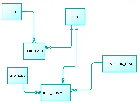

I'm working on a web application that has users with multiple roles and each user can perform multiple operations, based on user's role, and the permission level the role has on the operation. I came up with the following schema.
Users
| UserID | UserName          |
| 1      | Alice             |
| 2      | Bob               |
| 3      | Charlie           |
| 4      | David             |
Roles
| RoleID | RoleName        |
| 1      | Tech_Admin      |
| 2      | Tech_Normal     |
| 3      | Non_Tech_Admin  |
| 4      | Non_Tech_Normal |
PermissionLevels
| PermissionLevelID | PermissionLevel      |
| 1                 | Tech_Account         |
| 2                 | Non_Tech_Own_Account |
| 3                 | Non_Tech_Any_Account |
| 4                 | Own_User             |
UserRoles
| UserID | RoleID |
| 1      | 1      |
| 2      | 2      |
| 3      | 3      |
| 4      | 4      |
Commands
| CommandID | CommandName  |
| 1         | CREATE_USER  |
| 2         | EDIT_USER    |
| 3         | VIEW_USER    |
| 4         | EDIT_PROFILE |
| 5         | VIEW_PROFILE |
| 6         | SUSPEND_USER |
RoleCommands
| RoleID | CommandID | PermissionLevelID |
| 1      | 1         | 1                 |
| 1      | 1         | 3                 |
| 2      | 2         | 1                 |
| 3      | 2         | 2                 |
| 4      | 5         | 4                 |
For simplicity, I have not described account details but each user belongs to an Account - 'Tech' or 'Non-Tech'. There is only 1 Tech Account in the System.
Here are sample business rules as per RoleCommands table.
  • Tech Admin can Create Users in Tech Account.
  • Tech Admin can Create Users in any Non Tech Account.
  • Tech Normal can Edit Users in Tech Account.
  • Non Tech Admin can Edit Users in their own Non Tech Account.
  • Non Tech Normal can view their own profile - which from the table means other users cannot view this user's profile.
When I receive a new REST API request, I will identify the operation based on the request paramters and verify if the user has permission to perform the operations based on RoleCommands table. Does this look like a reasonable design for Role and Permission management ?
Update
It looks like there will be too many records in the RoleCommands table because, for each command, there will be several combinations with roles and permission levels. For a given object, there can be n (for eg: 10) statuses in which the object can be. I want to give View_Object_Status1 command permission to a user so that the user can view the object when its status is Status1. That is blowing up the RoleCommands table. What is the best way to simplify this ?

Your current design is this:
You should ask yourself:
  • does entity PERMISSION_LEVEL represent actual levels?
Is they are actual levels it means that when a user is granted two different roles and both roles have the same command but with different levels, the app should take the highest level of them. In role-permission models with no permission level, set logic is used, so if an user ends up with the same permission twice, it doesn't matter. What matters is that the permission exists in the set, not how many times it exists. But your model has permission level and so you should decide what to do when a user ends up having the same role command more than once with different permission levels.

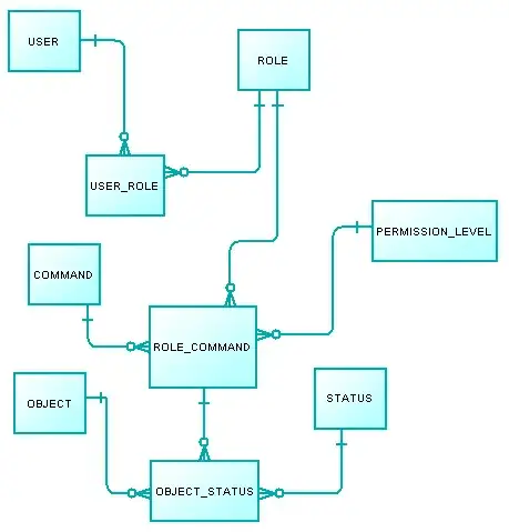

In the other hand in the update of your question you mention a new entity that is not shown in the model which is OBJECT.
  • Where does object fall into the model?
For what I can see the model would be updated like this:
That would actually considerably increase the row number of the resulting table. But that should not worry you too much if you create the proper indexes and FK. What does worry me is the complexity assembling the roles but at least that should be done only once.
The term "reasonable" is somewhat ambiguous here.
Fit for purpose
This design achieves it's purpose. It enables to determine what operations any logged-in user can do on any specific business object :
  • Users are identified
  • Roles are identified
  • Users are assigned to roles
  • Commands are identified - apparently a command refer to an operation on a business object (user accounts in this example)
  • Permission levels are identified - apparently the permission level restricts the business objects that are managed in commands
  • Commands with permission levels are assigned to roles
Strength
This design allows easy day to day role based access management, as expected in modern business applications.
This design is flexible. It allows to tailor the roles with a very fine granularity so that it enables to implement any possible access configuration that could be desired (assuming that the permission level appropriately represents the segmentation needs in that matter).
Weakness
The construction of roles requires the explicit entering of all the combinations. This could be tedious, if commands or permission levels are too fine grained.
The permission level is common across all business objects:
  • If you only manage a couple of business objects, that share similar access rules, it's ok.
  • If you'd need diffenet access rules on different business objects, you'd need to add more permission levels, with a risk of inconsistency between the command and the permission level.
By the way, the current list of permission levels doesn't cover unambiguously the whole set of data: I'd suggest to rename "Own" into "Tech_Own" and "Tech" into "Tech_any". I understand that "any" means "any except his own".
Edit:
Following your comment about managing several business objects, I'd suggest that you add a business-object table, and change the command table and the permission-levels, so that they both relate to a business object.
In this way, you will be sure that your profiles will always relate compatible commands and permission levels: you just have to introduce the business-object-id in this table.
This will not make the roles simpler, but this would not only solve your problem but also allow to offer to the role manager a nice user interface to facilitate the entry (always chosing among compatible elements)
Christophe
  • 74,672
  • 115
  • 187
  • Own_User is applicable for both Tech and Non-Tech users. There is only 1 Tech account in the system. And permission levels ending with _Account are applicable to Account level commands like Create_User or Edit_User in that account. Commands ending with _User are applicable to user level commands like Edit_Profile. Though there is no restriction at program level on that. I agree roles entering is tedious. I already encountered that when reviewing the design with sample data on white board. Any suggestions for improving this ? – TechCrunch Jul 10 '16 at 01:40
  • I could not comprehend points under "The permission level is common across all business objects:". Can you please elaborate ? Thank you. – TechCrunch Jul 10 '16 at 01:40
  • @TechCrunch "across all business object": suppose your system also manage orders. The commands would be create/update/view/cancel_order. But the permission level would not be related to tech/non-tech but more about the amount ordered. You'd then add these new levels. But as the list gets longer and longer s.o. Might end mixing order commands with levels for users or user management commands with permission levels related to order value. If you only manage user profiles/accounts in your system and commands related to tech/non-tech everything is fine – Christophe Jul 10 '16 at 08:13
  • like you said, we have Licenses in our system and the Licenses are to be approved by Tech or Non-Tech users depending on License Type and some other options chosen during License application. – TechCrunch Jul 10 '16 at 18:46
  • my RoleCommands blew up as I had to give view permission for each status on various business objects. What is the best way to simplify ? – TechCrunch Jul 11 '16 at 11:56
  • @TechCrunch For example add a business object table, relate commands and permission levels per business objects. – Christophe Jul 11 '16 at 12:15
