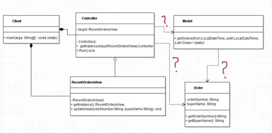

Now I want to create a UML diagram for this setup, however I don't know if I should use aggregation or composition between Controller, Model and Order
my best guess looks like this: enter image description here
I have selected composition relationship between Client and RecentOrdersView and Controller, because Client owns an instance of each. I have also selected an aggregation relationship between RecentOrdersView and Controller, because Controller holds a reference of RecentOrdersView (even though it does not own it).
where I am confused is the relationships between Order, Controller and Model. Specifics:
Relationship between Model and Controller: I know that Controller calls a static function in Model, but since there is no object instances, I am unsure what to do
Relationship between Model and Order: I almost want to use composition because Model instantiates Order objects, but since this happens in a static function there is no immediate owner, the Order objects get passed back to Controller
Relationship between Controller and Order: inside Controller method Run() is where Order objects fall out of scope, but Controller object is not the one that directly instantiated those objects. should I be using composition here?

Here is a good explaination on differentiating association, aggregation, and composition.
But here's a thing. If you try to show everything your system is capable of (or every description of your system) on the same diagram, you're going to run out of relationships, or end up reusing the relationship kinds with widely different meaning on the same diagram.
You're showing several different kinds of things on the same single diagram. The order is mostly an informational entity. The model is largely informational as well (it is the collection of orders), but of course, has some low-level (CRUD) behaviors around persistence. Whereas the controller and view are a mostly behavioral entities.
If you choose instead to use more than one diagram may help clarify things both for you and the consumers of your documentation.
For example, I might suggest that a sequence diagram would more effectively illustrate the interaction (the dynamic relationship) between a controller, the model, and an order. (Personally, I would hesitate to describe the controller/order relationship as even a mere association because that relationship is never materialized in a formal way or persisted for any duration.)
An object diagram (or block diagram, rather than a class diagram) can be effective at showing the full-program lifetime (primordial) singletons (objects, sometimes subsystems and modules), like model and its relationship with, say, the top-level controller object. As such these are a good at showing design at the highest level.
A class diagram for showing the composition relationship between model and orders (which I am presuming cannot exist or do not make sense without being in the model).
(Technically, the class diagram relationship between the controller class and order class is via a return type on a method in Model, this is one reason why I would hesitate to describe this as an association between classes controller and order; however, that is probably not all that interesting for a top-level diagram intended to show the system design, especially when you might use another diagram to show that instead.)
