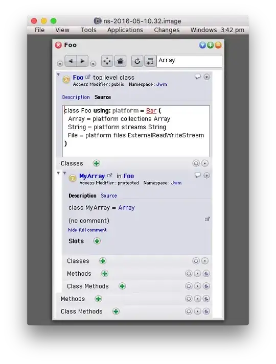

Newspeak:
class Foo using: platform = Bar (
  Array = platform collections Array
  String = platform streams String
  File = platform files ExternalReadWriteStream
  class MyArray = Array () () : ()
Note that the way a Newspeak programmer is actually going to see the class(es) is like this:Newspeak IDE displaying multiple nested classes
I can't even begin to do it justice, though. You'll have to play around with it yourself. Gilad Bracha has given a couple of talks about various aspects of the system, including modularity. He gave a really long (2hr) talk, the first hour of which is a thorough introduction to the language, including the modularity story. Chapter 2 of The Newspeak Programming Platform covers modularity. If you skim Newspeak on Squeak – A Guide for the Perplexed (aka Newspeak-101), you get a feel for the system. Newspeak by Example is a live document (i.e. it is running inside the Newspeak-on-ECMASCript port, every line of code is editable, every result is inspectable) demonstrating the basic syntax.
But really, you have to play around with it. It is just so different from all mainstream and even most non-mainstream languages that it is hard to explain, it has to be experienced.
