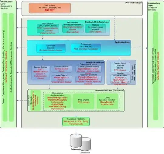

So my question is if the top layer is REST API and there is no need for any UI, is REST api considered as a presentation layer or application layer?
Update
Since I received some comments how this question has nothing to do with DDD and that there is no presentation layer in DDD etc, not to confuse application layer in OSI etc.., I decided to add this .
It appears that there is also an distributed interfaces layer that would actually handle this scope.
So basically presentation layer is a part of DDD architecture, just not the heart of this architecture. Also web services in a form of .net web api (rest) would exist in this distributed interfaces layer.

    Where did you get this diagram from? – Robert Harvey May 12 '16 at 07:25
  • http://www.joaopauloseixas.com/howtodoit.net/?p=2718, based on https://blogs.msdn.microsoft.com/marblogging/2011/05/23/domain-drive-design-n-layered-net-4-0-architecture-guide/ – Dario Granich May 12 '16 at 09:05

  • My question was about rest api not just rest in general . I was referring to DDD when using onion architecture example http://www.infoq.com/news/2014/10/ddd-onion-architecture , not just domain layer. – Dario Granich May 12 '16 at 06:32
  • In the diagram you provided, REST is part of the *Distributed Interfaces Layer.* The infoq article you linked has neither an Application Layer nor a Presentation Layer. Are you sure you're reading these diagrams properly? What, specifically, do you want to know? – Robert Harvey May 12 '16 at 07:20

    @DarioGranich" What exactly are you trying to figure out? The diagram is as plain as day. In *that* architecture, the REST interfaces live in the "Distributed Interfaces Layer." It would seem that you're reading a bit too much into this. If you told us why you need to know, we could probably better assist you. What specific, real-world problem are you trying to solve? – Robert Harvey May 12 '16 at 13:47
