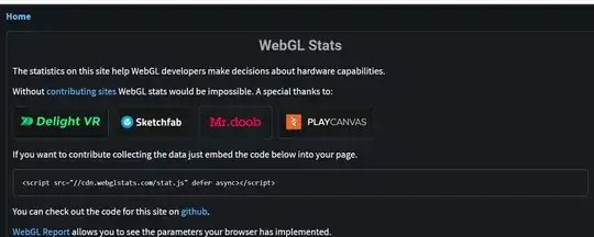

Data collection based on community effort is a necessity:
WebGL Stats
