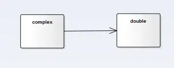

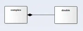

On one hand
class complex {
    double real;
    double imaginary;
it is composition
on the other hand
class complex : double {
    double imaginary;
it is inheritance
Which one is correct? Why arrows go opposite direction, denoting the same thing? Who invented all this?

The association marker isn't an arrow, it's a binary relation that is marked on one side (so you can distinguish dog-has-tail from tail-has-dog). And the inheritance arrow looks as if it is "moving" into one particular direction, but there is no particular reason why anything would notionally move from the superclass to the subclass, or from the subclass ot the superclass. Again, it's just a means of marking the asymmetric relation, which is necessary because the difference between "A is-a B" and "B is-a A" is important.
More generally, these notations are largely arbitrary in the same way that writing "A" for one particular vowel sound and "B" for a particular consonant is arbitrary: none of these signs has any special affinity for the thing they denote, and we might just as well have chosen different symbols. The important thing is that now everyone agrees how to write down sounds.
Similarly, in OOP we now largely agree how to draw a class diagram, and this allows us to communicate more efficiently, even when the devices we use for notation are not especially compelling. Wondering why one kind of arrow stands for one thing and another kind for another thing can only teach you about the history of UML, not actually about software development, therefore it kind of misses the point.

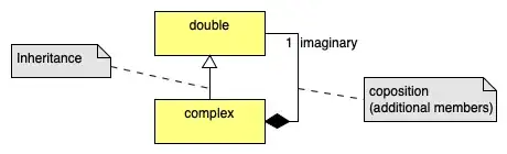

Your first UML model says that a complex number is composed of 2 doubles. This is definitively an acceptable way to it.
Your second UML model does not represent the corresponding code: you don't show inheritance but a navigable association, and you forget to tell about the additional member. The following would more accurately represent the code:
However, this does not represent the reality: a complex is not a kind of double. For example, if x is a double, I can always assume that x*x >= 0. So for any subtype of double, I'd assume that this fundamental assumption remains true. This is exactly what Liskov's substitution principle means with its rule about post-conditions. So, as the square of a complex can be negative, the complex is not a proper subtype of a double. Transposed to OOP, complex should not inherit from a double.

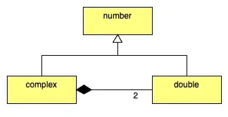

Your second option however unveils a fealing that there must be something in common between doubles and complex. Well, they are both numbers. And this you can very well express with the following model:
Now, you may just continue, with modelling the number theory, starting with defining the number interface. This could be a nice step if you want to write a symbolic calculator
Additional note: Liskov's substitution principle was first defined by Barbara Liskov and Jeanette Wing, long before R.C. Martin took it over into his SOLID principles. It's not a dogmatic OOP rule, but a fundamental work on typing theory. Bjarne Stroustrup in his book "The design and evolution of C++" acknowledged for example that protected members allows to shortcut Liskovs's history constraint and that this was the cause of very nasty bugs that are hard to debug. So it's definitively not an obsolete principle;-)
