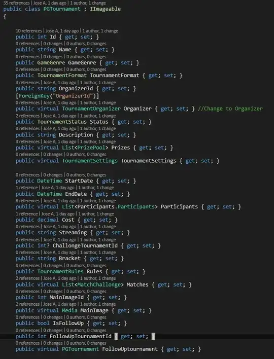

I'm in the process of redesigning a portion of my ASP.NET MVC application. I'm currently using Entity Framework 6.1 code first approach.
I've been reading as of late that (Correct me if I'm wrong, I don't know much about DBs): Joins are expensive; we should keep our database normalized and with the least queries executed as possible. Entity Framework does a join each time we "virtual" a property and try to retrieve it (Eager/Lazy Loading). We should avoid an Entity-Attribute-Value approach (EAV), unless denormalization becomes desirable (Correct me).
Code First approach allows us to write the DB schema using C# OOP code (POCO). Which means that we should adhere to OOP's SOLID Principles (Correct me). The first one is Single Responsibility, which means a class should do only one thing (again, correct me if I'm wrong).
Now here comes the problem (this is the first time it happens to me). I have a class with around 30 properties. Before thinking in anti-EAV, I went and separated the model accordingly:
As you can see I have many virtual properties without the List<> type, this means that it is a one-to-one relationship. I have read in a previous stack-overflow post that a good rule of thumb is that one-to-one relationships should be avoided in favor of having them in a same table. That is, of course, if that one-to-one is not called from other tables. We prevent EAV and therefore, Joins.
Following SOLID principles, I have extracted some properties to external classes. They will get their own table.
So, the question will be, should I favor a fully normalized design over a OOP Approach when modeling in Entity Framework?
Such properties are known as navigation properties because the "navigate" to other entities. Lists are collection navigation properties and entity-type properties (without the List<> type) are reference navigation properties. They don't have to be virtual. When they're virtual, EF may be able to lazily load the properties.
Why? Reference navigation properties are often the "1" part of a 1:n association. I think most of your reference properties are like that. For example, GameGenre. I think there are many tournaments having the same GameGenre. It's a 1 (genre) to n (tournament) association, even if GameGenre doesn't have a Tournaments collection. Maybe only TournamentSettings and MainImage are actual 1:1 associations.
1:1 Associations distribute data belonging to one entity over multiple tables. There can be very good reasons to do that. One of them is to facilitate querying light-weight data without the heavy payload of some blob, like MainImage. Another one is separating sensitive data from public data. Or common data (often queried) from specialized data (queried sometimes), maybe your TournamentSettings.
