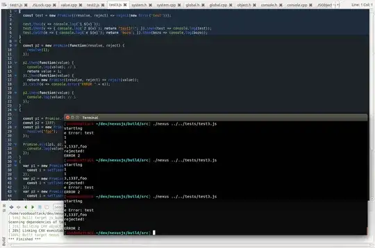

The following is a picture of promises running on all CPU cores in parallel with no contention:
Running promises concurrently.

  • I have edited the question with proof that promises work in parallel with no synchronization problems of any kind, and I included the source code. Please prove me wrong. – voodooattack Apr 14 '16 at 17:56
