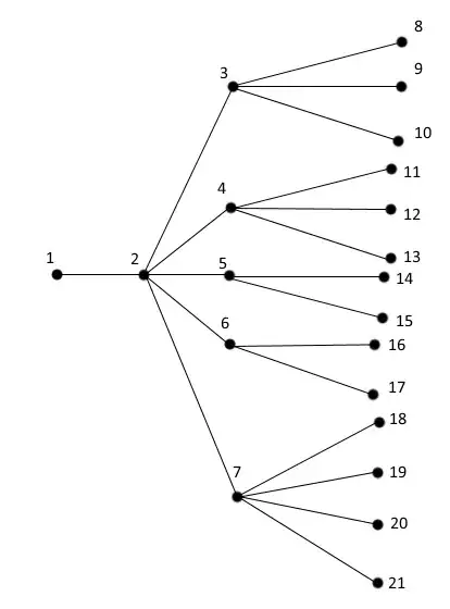

What I am trying to do is a tree-based control flow where each branch has no dependency on another branch. Consider this chart showing my control flow:
Program's tree-style control flow
  • (1) Make an async REST request to get projects
  • (2) 5 projects received. For each project received, (a) create a project instance and (b) make an async REST request to get teams of that project
  • (3-7) x Teams received. For each team received, (a) create a team instance, (b) add the team as a member to its parent project instance, and (c) make a REST call to get all team-members of that team
  • (8-21) x team-members received. For each team-member, (a) create a team-member instance and (b) add it as a member to its parent team instance.
What is important to note here is that in order for 8-21 to happen, 3-7 don't all have to be done. Basically, what I am trying to achieve here is once 2's response is received, do 3, 4, 5, 6, and 7. As soon as 3 is done (not caring about 4-7), do 8-10.
However, I am not sure which Promise constructs to achieve this tree-like control flow, since 8-21 is not all dependent on 3-7's completion.

The main problem seems to be where to branch and where to join asynchronous executions. In your sample code you're trying to use a single point to join non-dependent operations. The trick here is to use many branches and joins; say you have an array of projects, and load teams. Then you have a list of promises, and for each you will start a new branch and have a new promise. When chained correctly, things start to clear up and look simpler:

  • I now see how `Promise.all(...)` aggregation applies to my non-linear flow, and your example is a good demonstration of that. Applying to my original post, even though 8-10 don't have to wait for all of 3-7 to be complete, 2 _will not_ be complete until 3-7 are, so there still is dependency, which is why the `Promise.all(...)` still applies to this situation. Flattening it out ended up making a ton more sense, too. – Michael Plautz Apr 01 '16 at 18:33
