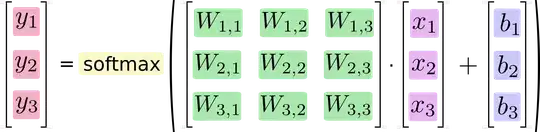

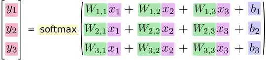

In Google's MNist tutorial using TensorFlow, a calculation is exhibited in which one step is equivalent to multiplying a matrix by a vector. Google first shows a picture in which each numeric multiplication and addition that would go into performing the calculation is written out in full. Next, they show a picture in which it is instead expressed as a matrix multiplication, claiming that this version of the calculation is, or at least might be, faster:
If we write that out as equations, we get:
scalar equation
We can "vectorize" this procedure, turning it into a matrix multiplication and vector addition. This is helpful for computational efficiency. (It's also a useful way to think.)
vector equation
I know that equations like this are usually written in the matrix multiplication format by machine learning practitioners, and can of course see advantages to doing so from the standpoints of code terseness or of understanding the mathematics. What I don't understand is Google's claim that converting from the longhand form to the matrix form "is helpful for computational efficiency"
When, why, and how would it be possible to gain performance improvements in software by expressing calculations as matrix multiplications? If I were to calculate the matrix multiplication in the second (matrix-based) image myself, as a human, I'd do it by sequentially doing each of the distinct calculations shown in the first (scalar) image. To me, they are nothing but two notations for the same sequence of calculations. Why is it different for my computer? Why would a computer be able to perform the matrix calculation faster than the scalar one?
