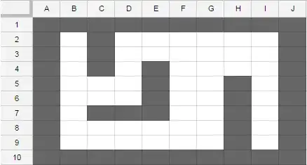

I have a rectangular grid of square tiles, some of which are blocked/filled. I start at a random tile inside the grid with the blocked tiles, randomly placed. I can turn in 90° steps and check whether I can enter the tile in front of me, which is possible if the tile in front of me is not a blocked tile or the edge of the grid. I cannot distinguish both cases from each other, I also have no coordinates and don't "know" my position in the grid.
I now need an algorithm to run through all open tiles of the grid. Using maze-solving algorithms (e.g. Pledge) makes me run along the walls of blocked tiles and the grid's borders, however it is possible that there are free tiles that are not adjacent to a wall, which do not get hit with these algorithms.
What kind of algorithm or logic do I need to use to make sure I cover all empty tiles?
Sample image:

  • Would you be able to provide us with an image of the sample grid? Even something basic like an Excel Chart with cells shaded a different color for if they are blocked or not to show your basic problem, like [this](http://imgur.com/D666Dv3) – Rachel Mar 10 '16 at 17:20
  • And as long as your making a sample grid, it would be helpful to see what the desired outcome for that grid would be. Would like you the description of an unblocked path back to your current position or to another position? Is it allowed to use a tile more than once? – Miguel van de Laar Mar 10 '16 at 17:28
  • Do you know the grid size? or maximum dimensions? –  Mar 10 '16 at 18:03
  • I actually find this question interesting. I am assuming this is more of a "room" with a grid interface and randomly placed "objects" in the room, and less of a "maze", and you need an algorithm to traverse every free square in the room from any starting point. Like a Security Guard pathing AI for a randomly generated room. I am guessing that it doesn't matter if the algorithm overlaps anywhere, due to the randomness of it. – Rachel Mar 10 '16 at 18:33
