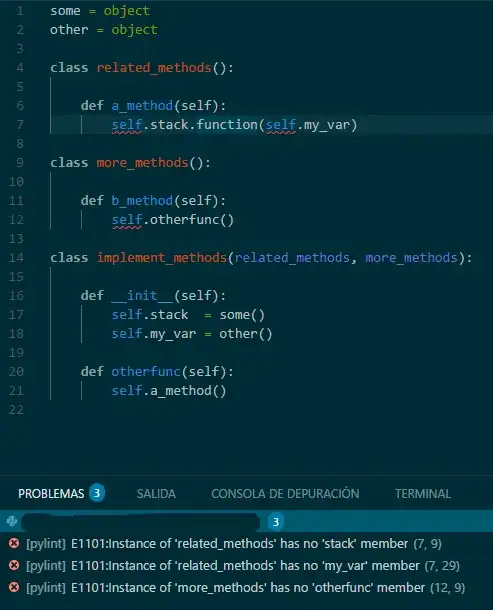

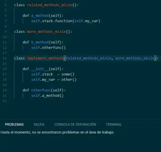

The linter is not aware that you use a class as a mixin. Pylint is aware that you use a mixin if you add the suffix 'mixin' or 'Mixin' at the end of the class name, then the linter stops complaining.
linter_without_mixins linter2_with_mixin
Mixins aren't bad or good per se, are just a tool. You make them a good use or a bad use.
