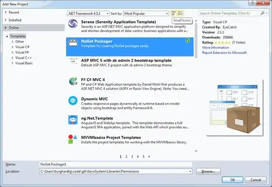

In short: create your own NuGet package feed
Since you are using the .NET stack for development, you can stand up your own NuGet package feed where you can place a NuGet package that contains the database API. You can release different versions in order to maintain backwards compatibility for integrating projects. Any project that wants access to the database need only fire up the NuGet Package Console in Visual Studio, then install-package YourDatabasePackage to include it.
If you update the public API for the database, then you release a newer version of that package to the server. Anyone not ready to use the new API stays on the old version of the NuGet package. When it comes time to use the new API, just fire up the NuGet package console again in your project and type update-package YourDatabasePackage then compile and fix bugs.
This gives all the integrating applications some buffer time in order to start using the new API, but also gives you a controlled manner to roll out updates.
When adding a new project to a solution in Visual Studio, you can look at the on-line templates for a project template called "NuGet Packager". This gives you a one-click way of creating a NuGet package project that compiles the project, creates the DLL file and creates the NuGet package file when you build the solution. It's a great way to start developing your own NuGet packages quickly.
Screenshot of add new project window in Visual Studio with NuGet packager template selected
