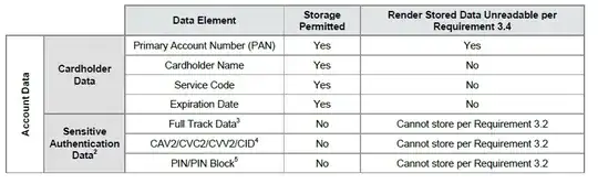

The hashed storage of the information is simply part of compliance with the scheme, not a means to avoiding compliance. Hashed data storage can be a means of complying with the data storage requirements (see table below). Account Data PCI Compliance
However, compliance with the rest of scheme (e.g. network topology, PC security, etc.) is not dependent upon how the information is stored.
