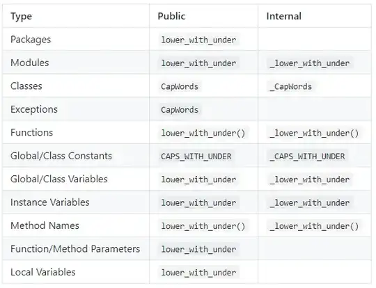

Quoting https://www.python.org/dev/peps/pep-0008/#package-and-module-names:
Modules should have short, all-lowercase names. Underscores can be used in the module name if it improves readability. Python packages should also have short, all-lowercase names, although the use of underscores is discouraged.
For classes:
Class names should normally use the CapWords convention.
And function and (local) variable names should be:
lowercase, with words separated by underscores as necessary to improve readability
See this answer for the difference between a module, class and package:
  • A Python module is simply a Python source file, which can expose classes, functions and global variables.
  • A Python package is simply a directory of Python module(s).
So PEP 8 tells you that:
  • modules (filenames) should have short, all-lowercase names, and they can contain underscores;
  • packages (directories) should have short, all-lowercase names, preferably without underscores;
  • classes should use the CapWords convention.
PEP 8 tells that names should be short; this answer gives a good overview of what to take into account when creating variable names, which also apply to other names (for classes, packages, etc.):
  • variable names are not full descriptors;
  • put details in comments;
  • too specific name might mean too specific code;
  • keep short scopes for quick lookup;
  • spend time thinking about readability.
To finish, a good overview of the naming conventions is given in the Google Python Style Guide.

Here is a link for different types of Python name conventions.
The style guide for Python is based on Guido’s naming convention recommendations.
