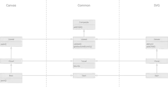

This is a general OOP question, assuming polymorphism, generics, and mixins are available. The actual language to be used is OOP Javascript (Typescript), but it's the same problem in Java or C++.
I have parallel class hierarchies, that sometimes share the same behaviour (interface and implementation), but sometimes each has its own 'protected' behaviour. Illustrated like so:
3 parallel class hierarchies, the centre column shows the common parts, the left column is the canvas hierarchy and the right column shows the SVG hierarchy
This is for illustration purposes only; it isn't the actual class diagram. To read it:
  • Anything in the common hierarchy (centre) is shared between both the Canvas (left) and SVG (right) hierarchies. By share I mean both interface and implementation.
  • Anything only on the left or right columns means a behaviour (methods and members) specific to that hierarchy. For example:
    • Both the left and right hierarchies use exactly the same validation mechanisms, shown as a single method (Viewee.validate()) on the common hierarchy.
    • Only the canvas hierarchy has a method paint(). This method calls the paint method on all children.
    • The SVG hierarchy needs to override the addChild() method of Composite, but such is not the case with the canvas hierarchy.
  • The constructs from the two side hierarchies cannot be mixed. A factory ensures that.

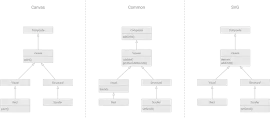

Solution II - Mixins
This is the only one I can currently think of. The two hierarchies are develop separately, but at each level the classes mixin the common class, which are not part of a class hierarchy. Omitting the structural fork, will look like this:
The three columns again, the left and right columns are parallel hierarchies, where each class also inherent from a common class. The common classes are not part of an hierarchy
Note that each column will be in its own namespace, so class names won't conflict.
The question
Can anyone see faults with this approach? Can anyone think of a better solution?

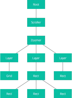

Essentially, in run-time clients compose instances hierarchy of Viewee subclasses; like so:
An image showing a hierarchy of objects like layer, rect, scroller, etc.
Say all these viewees are from the canvas hierarchy, they are rendered by traversing the hierarchy can calling paint() on each viewee. If they are from the svg hierarchy, viewees know how to add themselves to the DOM, but there isn't paint() traversal.

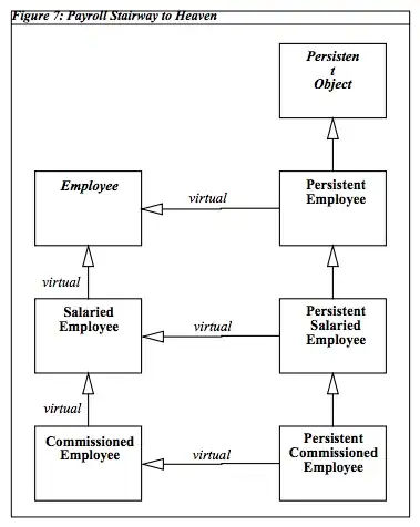

In an article titled Design Patterns for Dealing with Dual Inheritance Hierarchies in C++, Uncle Bob presents a solution called Stairway to Heaven. It's stated intent:
This pattern describes the network of inheritance relationships that is needed when a given hierarchy must be adapted, in its entirety, to another class.
And the diagram provided:
A class diagram with two parallel inheritance structures, where each class on the right also virtually inherent from its twin class on the left. The left hierarchy is also based completely on virtual inheritance
Although in solution 2 there isn't virtual inheritance, it is very much in accord with the Stairway to Heaven pattern. Thus solution 2 seems reasonable to this problem.
