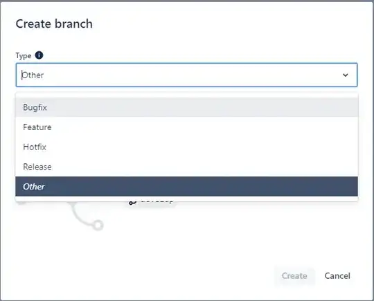

Bitbucket has default branch prefixes that include Bugfix. The idea is that a Bugfix can be any bug fix in a develop or release branch, but a Hotfix is specific for a fix to be directly applied to master (i.e. a production bug fix):
