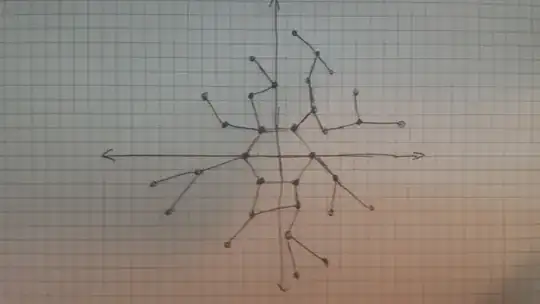

I am creating a 2d game for a website where the universe can grow extremely large (basically infinitely large). Initially, the universe is composed of 6 stars that are an equal distance from the origin (0, 0). My task is to be able to generate more stars that will have "paths" (edges) that connect to each other. How can I design an algorithm that meets these restrictions:
  1. Stars are randomly generated outward. (e.g. (x, y) coordinates for new stars will slowly go outwards from (0, 0) in all directions, preferably in spiral format)
  2. Edges will NOT cross.
  3. Although there should be some variance, new stars should not be too far or too close to other stars. (E.g. there must be a minimum radius)
  4. No star/point should have a multiplicity of more than 3.
  5. Given that all of this will be stored in a Database, the algorithm cannot be too costly. In other words, I would love to achieve something of O(n) complexity (I don't know if this is feasible).
Essentially, what I am going for is a spiral looking galaxy where the stars are points on the graph and travel between stars is depicted by edges between those stars.
The particular steps I need to solve are:
  1. Randomly generate a point in the neighboring vicinity of other stars that do not yet have a multiplicity of 3.
  2. Find the first star that does not yet have a multiplicity of 3 that will not generate edge conflict.
  3. If the star is a minimum distance of x units away then create an edge between the two points.
I tried looking for solutions, but my math skills (and knowledge on Graph Theory) need a lot of work. Also, any resources/links on this matter would be greatly appreciated.

Finally, in case nothing makes sense above, I have included an image of what I would like to achieve below:and etc, alot of stars...

    What will you do if each generated star has exactly a multiplicity of 3, so step 1 will fail? Any why is in your picture one point with a multiplicity of 4, is that an error? – Doc Brown Jan 12 '16 at 08:16
    No. If you can generate stars in a predictable way, then it will be as if they had always been there if you leave and then return. It is only the algorithm and the seed which don't change. – Neil Jan 12 '16 at 08:19
  • @Neil I must investigate this further then; in that case I'll just have the algorithm client side and remember the connections via the database. – John F. Jan 12 '16 at 08:25
    @Doc Brown, there will always be atleast one star that doesn't have a multiplicity of 3. I guess I better explain that part better. Every time a user creates an account on the website 1 star will be created. That star would then connect randomly to a star that doesn't have a multiplicity of 3. Also, I don't see any with multiplicity of 4, it must be the coordinate system that makes it look that way. Please excuse my terrible drawing skills. – John F. Jan 12 '16 at 08:25
    @J.F.: in your picture, it is the point in the upper left quadrant, next to the origin. It has four connections to other points. – Doc Brown Jan 12 '16 at 10:27
    @Doc Brown oh ok yea, that is an error – John F. Jan 12 '16 at 14:31
