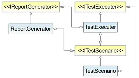

By using interfaces you can solve the circular dependency.
Current design:
Proposed design:
In the proposed design concrete classes don't depend on other concrete classes but only on abstractions (interfaces).
Important:
You have to use the creational pattern of your choice (maybe a factory) to avoid perfoming new of any concrete classes inside any other concrete class or calling getInstance(). Only the factory will have dependencies on concrete classes. Your Main class could serve as factory if you think a dedicated factory would be overkill. For example you can inject a ReportGenerator into TestExecuter instead of calling getInstance() or new.
